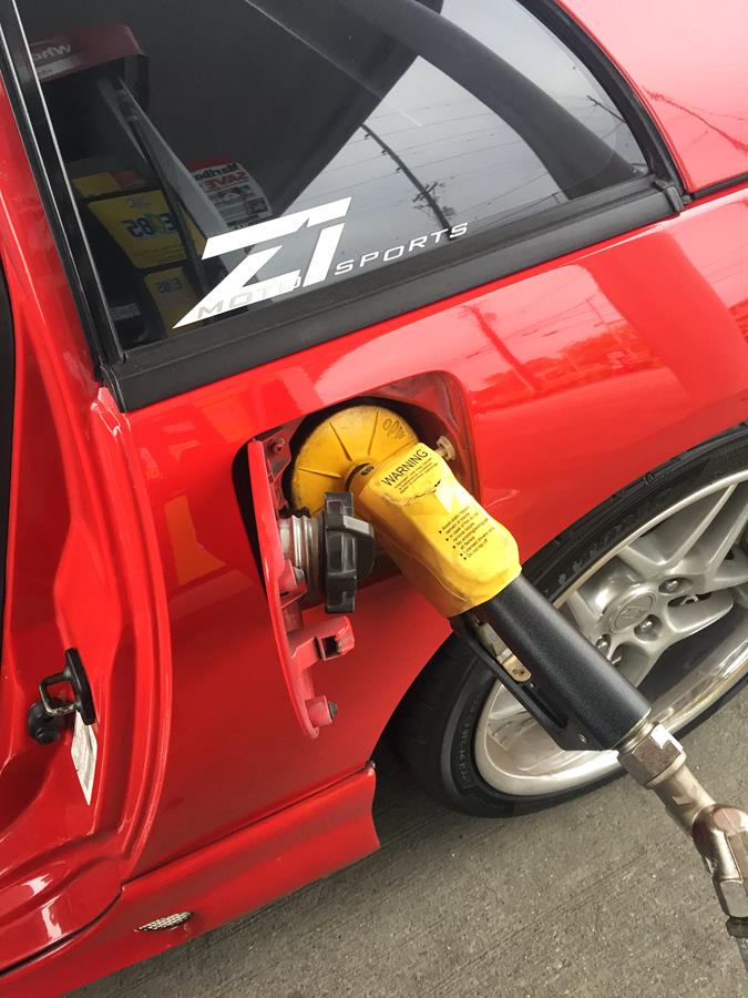

E85 Time

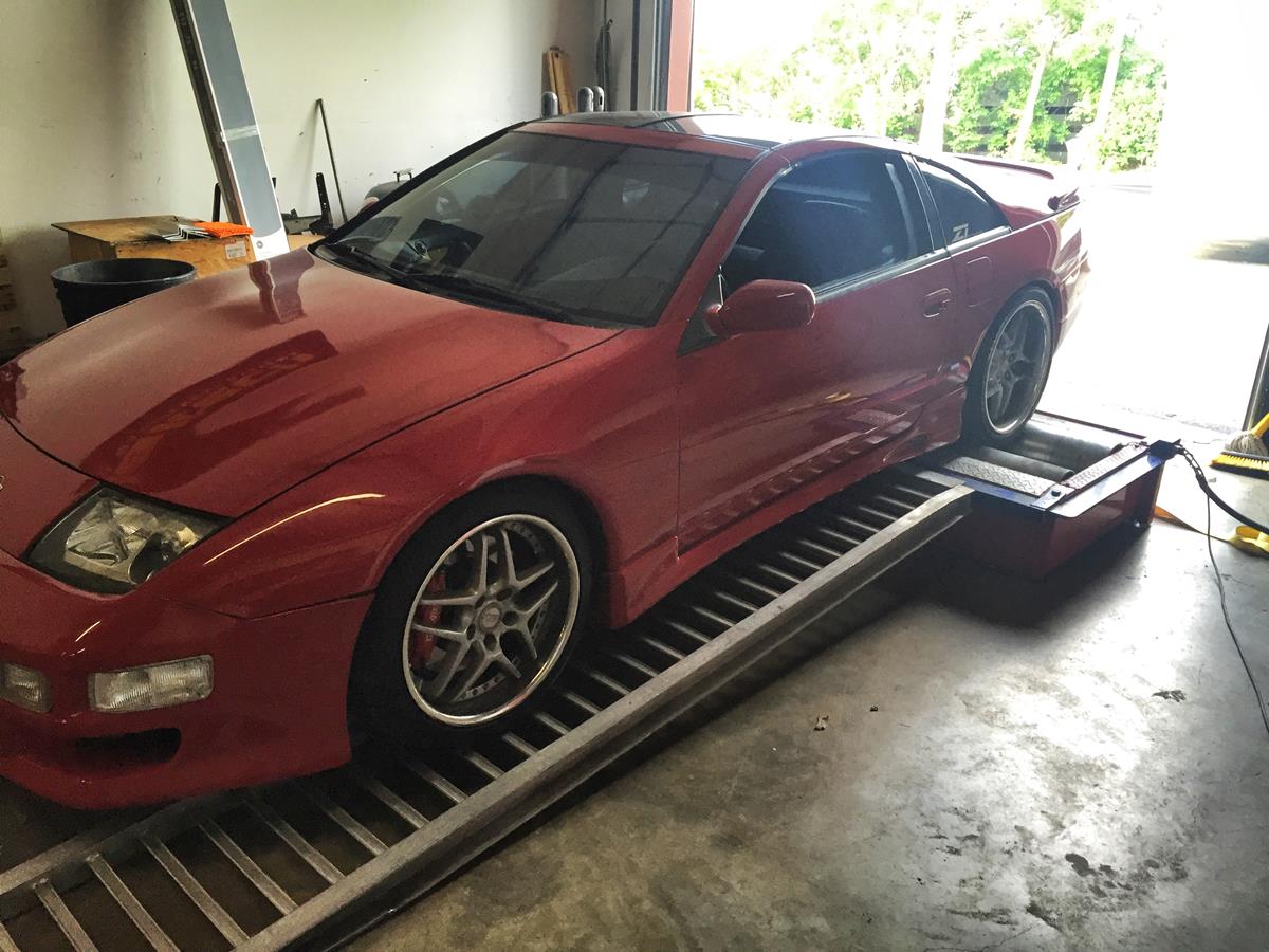

Headed to dyno

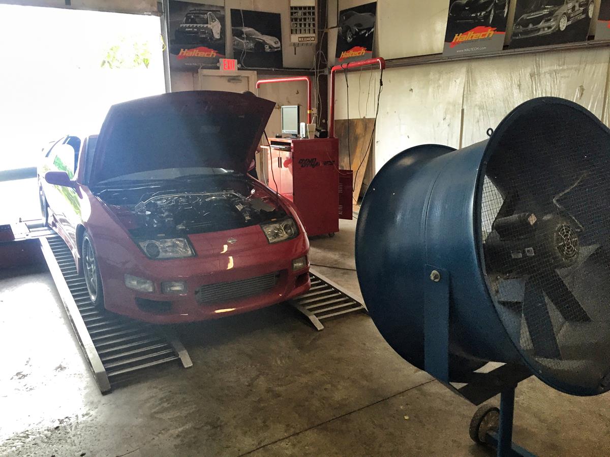

Getting setup

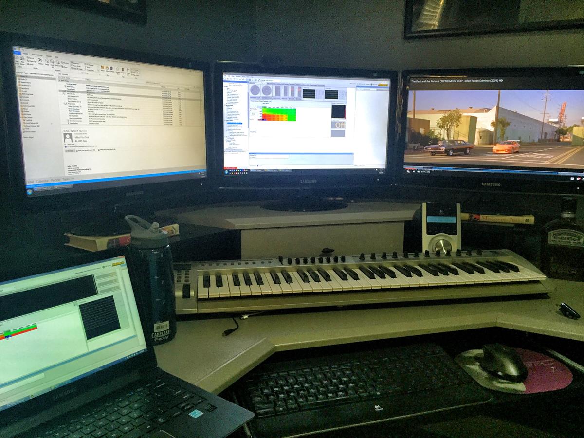

Starting to fill out the map

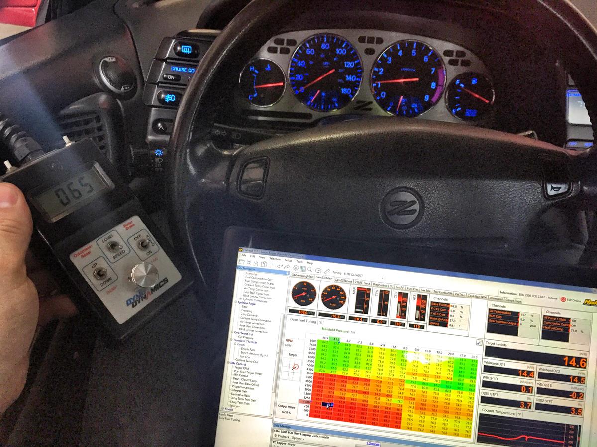

It was a great learning experience but unfortunately I wasn't able to finish. I was up to 25 PSI and hadn't really started bringing up the ignition map when I started have home / ref sync issues over 6K. The car had been running great all day so my guess is that I have a CAS starting to go out. No big deal. With what I got done I hit 525 hp on a VERY old dyno dynamics which from what we have seen is ~600hp on a dyno jet. From looking at how the car was making power with the boost / ignition that I was adding my guess is that when I finish it will shake out in the 650 ish range....and maybe a little more depending on how greedy I want to get it :)

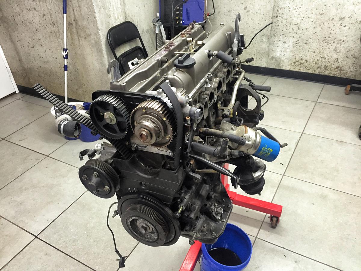

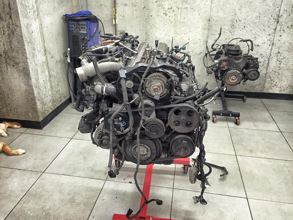

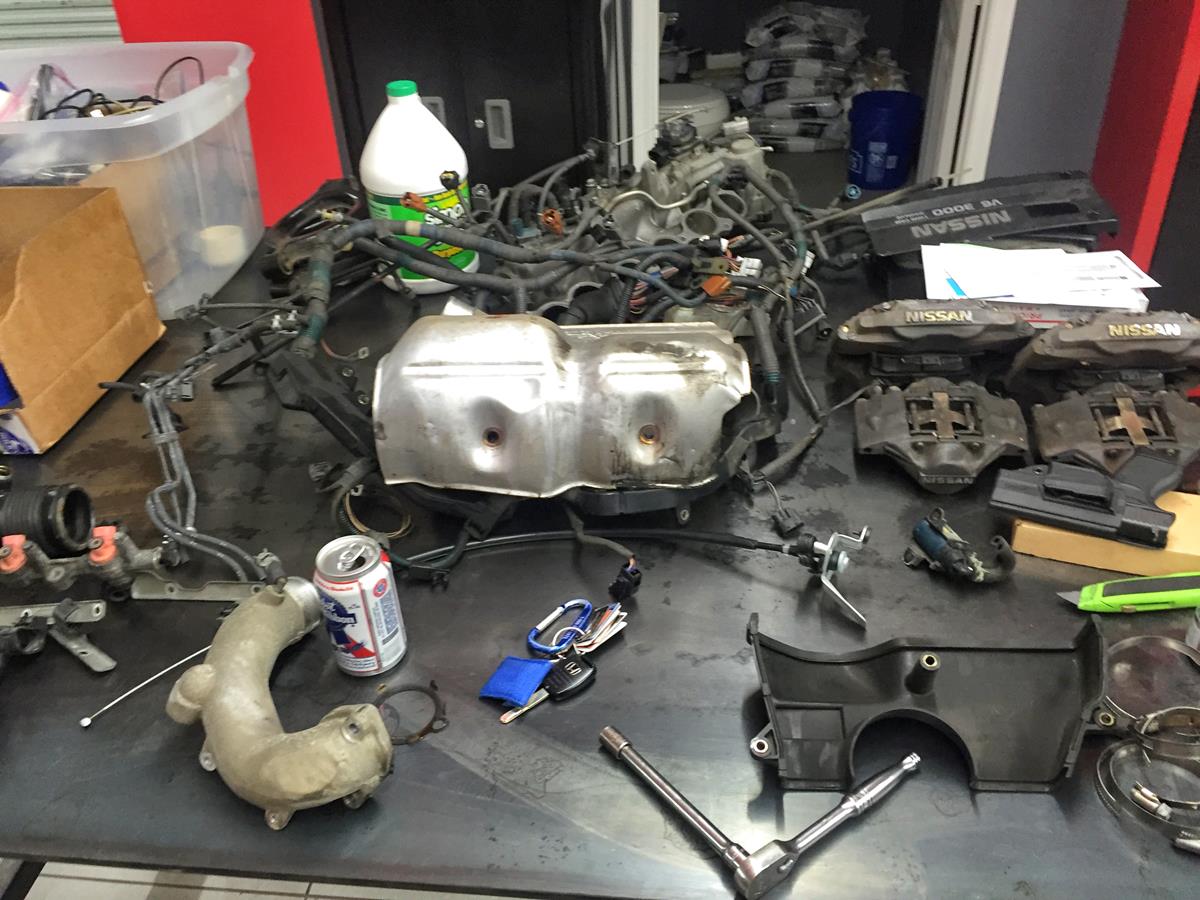

After tuning got home and finished stripping another 2J down for a build

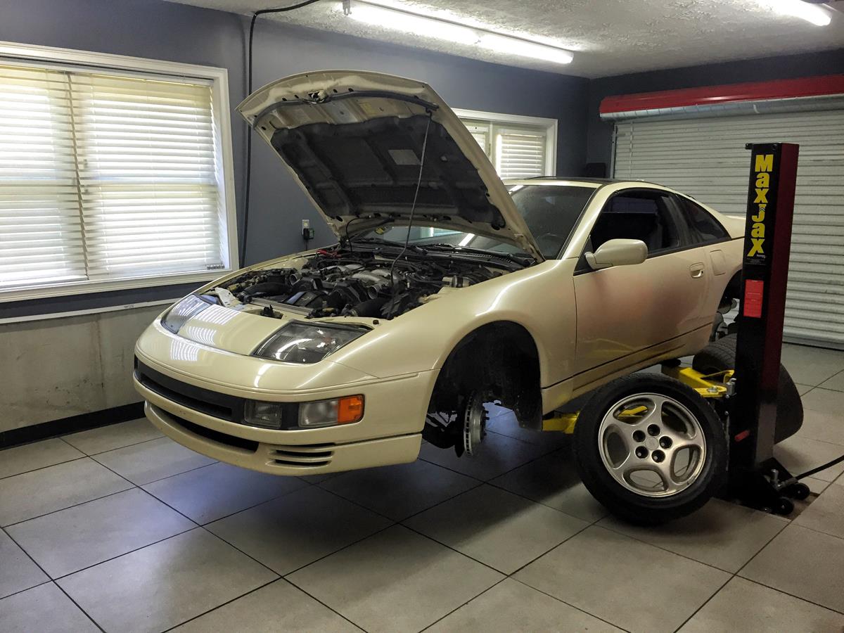

A long time customers 90 auto twin turbo Z with ~40K original miles that Justin and I are finishing up maintenance work on.
